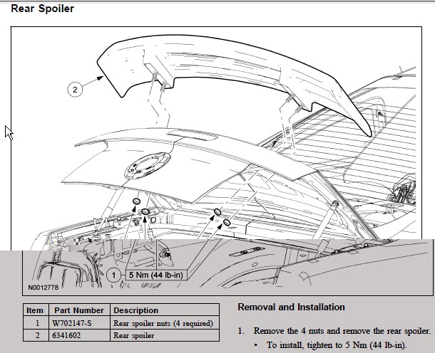

Spoiler removal / installation
http://www.ehow.com/how_6146709_install ... stang.html" onclick="window.open(this.href);return false;
