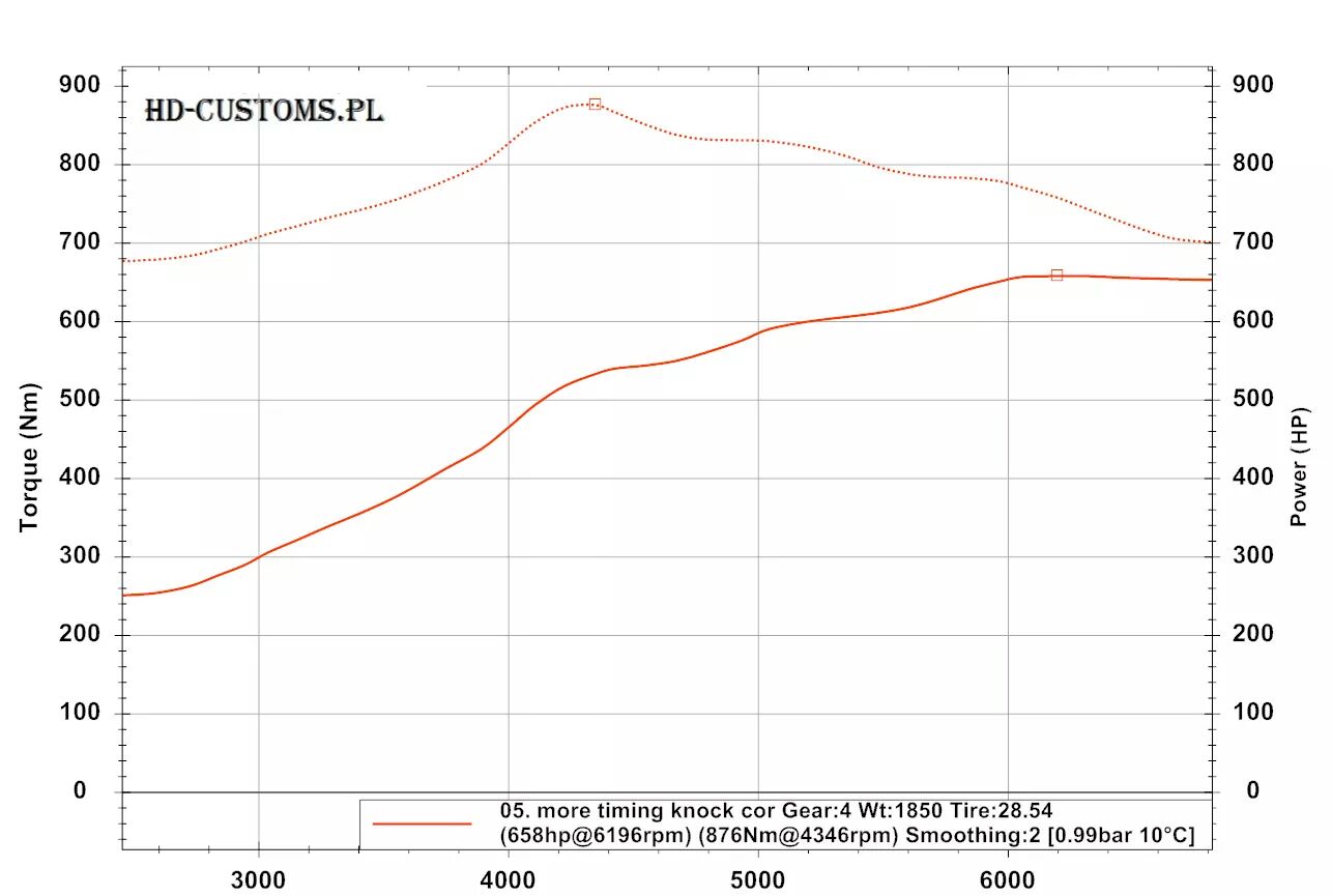

Mustang 2015 supercharged manual, 3.73, 660-670hp.
Waga testowa, test weight 1850.
0-100 4.73
0-200 12.10
100-200 7.42 with 3 shifts! Z 3 zmianami biegów
1/4 12.14 with 4 shifts, z 4 zmianami biegów
